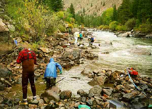

We examined the gravel bar and selected a likely looking spot and began pitching rocks. It seems like all of the good dredging spots are always under a rock pile. If there isn't a couple of yards of rocks to move, there probably isn't any gold. After about 15 minutes we had a clear spot all ready to dredge. We both put on our wet suits and started the dredge and then the fun began. Dave begun to ran the nozzle and I drug out the "serious" rock moving equipment. You can see it on the "Moving Rocks" web page. I then proceeded to drag and roll some large rocks out of the way as Dave dredged. After a couple of hours we traded off. I had expected to see a few other club members come by but they didn't take the time to carry their equipment up the river as far as I had. (They probably had more sense) After running about six hours we were both tired and ready to clean up for the day. We shut off the dredge and eagerly examined the sluice box. There were a few small flakes showing but nothing large. This was not unexpected as this area has glacial gold and it is mainly small sized. We lifted the upper riffle tray, pulled out the mats and washed the concentrates into a bucket. Then we removed the cover from the under sluice and did the same. Dave grabbed some of the concentrates and panned them out. Success. There was flour gold all over the pan. We both could see that dredging here would be different than what we were used to. We then moved the dredge up onto the bank, got out of our wetsuits and changed into dry clothes with a great feeling of satisfaction. We weren't rich money wise but were millionaires contentment wise. Hiking up the trail to the truck we discussed plans for tomorrow.

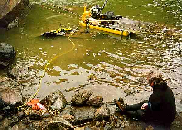

I drug the dredge into place from the bank, tied it off in the current and grabbed the footvalve. A quick push down into the water, a quick pull up to the surface of the water. Another push down and another pull up. Funny, that pulled up really easy. Looking down I saw the end of the suction hose minus the footvalve. It had come off. Instantly I began thinking all kinds of nice thoughts. In the current that I had the dredge anchored in, it had to be at least 1/2 mile downstream by now. Could I prime the pump with no footvalve?
Fat chance.
Could I purchase a replacement in town? Not much chance of that either. What about stealing the one off of the dredge that was sitting on the bank a hundred yards downstream? They probably wouldn't be on the river today. It would be possible to do but not something that I would do. With very little hope for success, I picked up my mask and snorkel and put them on. Sticking my head under the water I couldn't believe my eyes. The footvalve had dropped straight down into three feet of water and all I had to do is simply reach out and pick it up. The moral of this story is to screw a sheet metal screw through the hose into the foot valve assembly. This will prevent it from slipping off. You might not be as lucky as I was.

 The spot that we had dredged at the previous day was becoming rockbound so I moved over about ten feet and began a new hole. I dredged for three and 1/2 hours. The material I was working in was sandy and didn't have a lot of very big rocks in it. My past experience with this type of material wasn't very good so I wasn't very enthusiastic about working hard. Once as I surfaced and looked around I encountered a rainstorm. My partner, Dave, was sitting on a rock at the side of the stream hunched over and panning concentrates. I hadn't even been aware of the rain.
After the two previous days work I had about all of the dredging that I wanted for the day. After cleaning out the dredge and placing the concentrates into a bucket I panned a small pan to see what me results were. Success. Gold was flecked all over the pan. Feeling better about the days work I then drug the dredge back onto the bank, changed into semi-dry clothes, and gathered my wetsuit up and headed back to camp.
