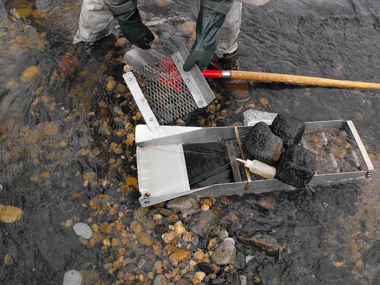

Rick, Dr. Sluice, joined Randy and I for some fun. Rick has an unusual way to run a sluice. It really works great. I've seen days that he has gotton more gold with his sluice then we did with our 4" dredges.
Here he is all set up.
Dr. Sluice at work
Taking a little break while the water does it's work.
Letting the sluice clear

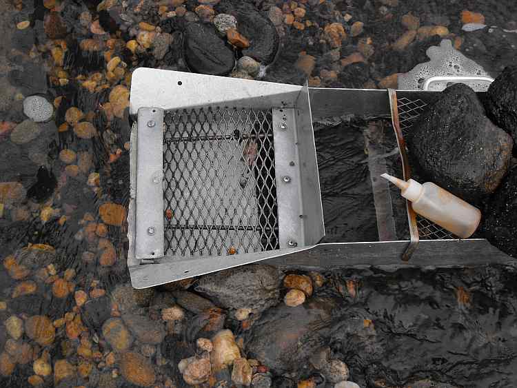

He has a special classifier right on the front of the sluice. Also, notice the rock try alowwing use of smaller rocks to hold it in place. Sometimes there just aren't any correct shaped rocks to span the sluice.
Home made classifier

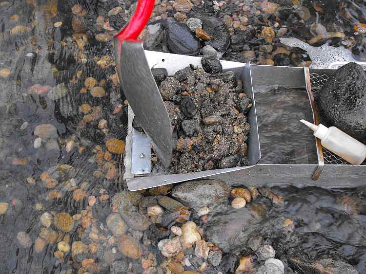

You just load it up with a shovel full and then splash water over it using the shovel to wash the sand and the gold through.
Ready to wash the fines through

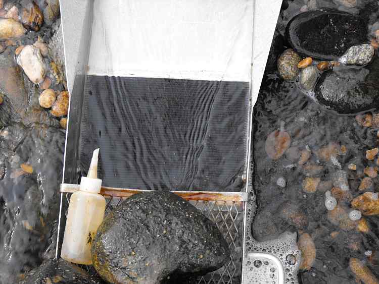

After the fines are washed through, remove the classifier to dump it. While it is off, you can inspect the rubber mat for the gold that shovel produced. Very handy for sampling
Dumping the coarse stuff
Checking the mat.
Mat inspection

Would his contraption, which classifies at the top of the sluice, would work/fit a Keene A52?

anything will fit when you make it fit!
Re: Dr. Sluice
Postby h20prospector » Mon Feb 22, 2010 10:15 am
russau wrote:anything will fit when you make it fit!
I believe you have commented on a couple of previous occasions that making things often times are better than making a purchase. What are your suggestions to someone who does not have the skills to fabricate something such as this, other than buying it?

Re: Dr. Sluice
Postby COArgonaut » Tue Feb 23, 2010 6:15 am

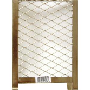

If you are not up to fabricating everything that Dr Sluice uses, you could do what Dr Sluice did and buy the parts.
He has a screen that fits over the top of the sluice that he can pile smaller rocks to hold the sluice down. This screen can be bought at any Home Depot or similar store. Go to the paint aisle and get the screen used to paint with a roller from a five galon bucket. They cost less then three bucks.
bucket screen.jpg (13.25 KiB) Viewed 7099 times
They real trick is to use it, and play with it. That is the part of what Dr Sluice has that you can't make or buy. He has an uncanny knack- eye ball a stream, dig there. He gets good gold often. But, not every time.
Good luck!
