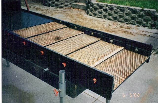

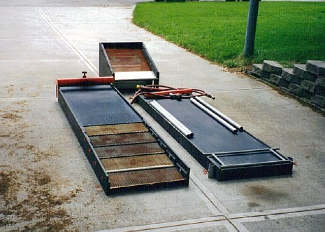

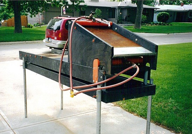

Postby tcfifer » Fri Mar 04, 2011 1:39 pm
Russ, here you go. I went ahead and posted the pics here Vs PMing them to you in case others wanted to see the design also. I could probably make one of these on my own for less that $100.00, maybe cheaper...just guessing. If you've got questions on construction or materials, let me know. Hope this helps.
TC

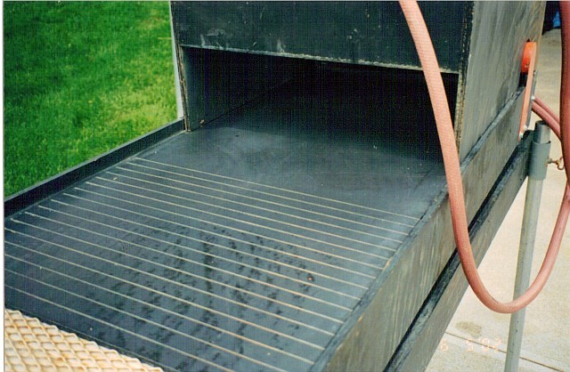

Tim is the stepped and grooved area on this table realy neccessary? i run my slate down to a peice of miners moss at the end. the slate is 48(?) inchs long. and when i run the water/angle right, the fine gold is in one area at the top of the table. and everything is screened and run seperatly in a closed loop and the water has Jetdry and Claygone in it.

I bought it that way Russ. There's a lot of redundency built in IMO. I can tell you that the shallow cuts in the slate top trapped a bunch of -100 stuff, where the stair-stepped felt under expanded would catch anything bigger. Most of the time though, the majority of the gold wouldn't even make it to the shallow cuts. The gold really sticks to that slate top.

Now this is a final clean up table right?? Very interesting. That's slotted slate at the header?? Nice!! :) :)

thanks all for the info and pictures. this was just what i was looking for! the Miller Table video i saw awhile back on youtube didnt show any slots or stepped down sections on their table. so thats what i went for.and yes its fairly heavy tobe moving it around.

I have a question on the table. How does the water flow? On two sections or three sections? In the picture I can't tell if the bottom table is just for structural support or the final cleaning section.

my table has only 1 source at the headend.
