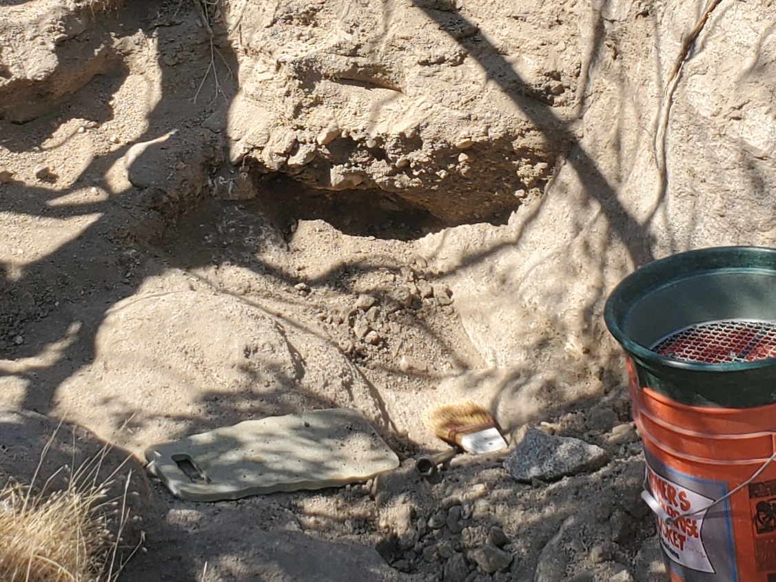

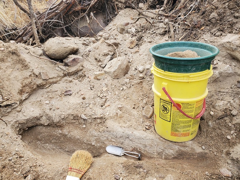

Did a few buckets today, 2 little pickers and 6 or 7 specks,As you can see the channel in some spots is covered in 2 to 3 feet of dirt, then you come to the river bed, i have moved up stream about 15 feet as to where i have found around 6 grams. it has not payed well these last trips, gonna keep moving up until the rain and snow come, there has to be more somewhere

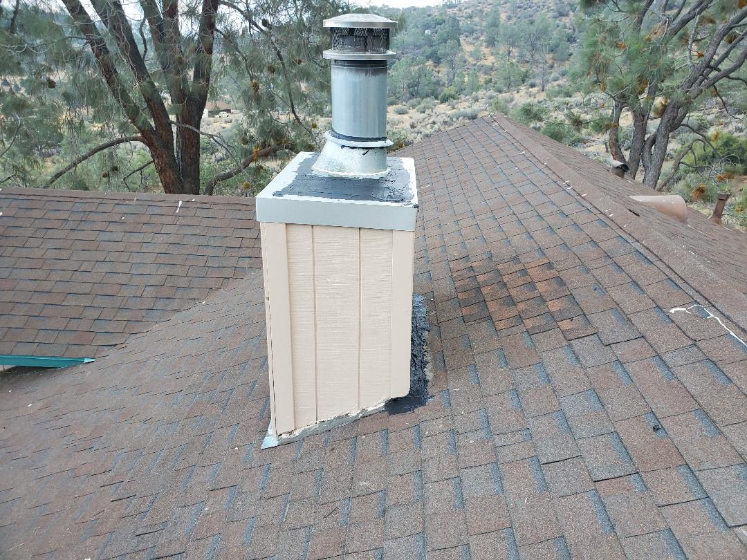

Thanks, didnt get to dig, had to fix this. now gimme a break its the first time i did a repair like this!,but view from the roof is great!

The next time you climb up there you might re-consider sealing completely around that chimney base, Ice dams sometimes form and melt water will, depending on circumstances, back flow up to the sides or bottom areas and travel inside the roof. I had that sort of thing happen on the kitchen's skylights 2 years ago here in Idaho and it took a gallon of 'stuff', a hand trowel and hours of meticulous troweling to get everything sealed up so absolutely no water could get through.
Another source of water can be wind drifted snow working back 'uphill' or into the sides and then through or into a crack. All of a sudden, when the weather warms, there is a drip inside and you can't figure out where it came from.

Thanks Joe, I tore out all the wood down to the frame and found that whoever made the thing just had a plywood top with Henrys tar on it,the whole deal rocked back in forth an inch or two , after i tore off one side i peaked in there and no rot on the roof wood at all, when i looked up at the stack i saw daylight above the flashing, they used some white color sealer that was hard and brittle,that was the source of the leak i believe, ,i do have a five gallon bucket of Henrys so i may just do as you said , but i will wait tell after the first real rain,and do it before the snow flys , which is usually December. the new top is all metal now, sealed top and bottom with Henrys

That sounds just like a solid plan!
