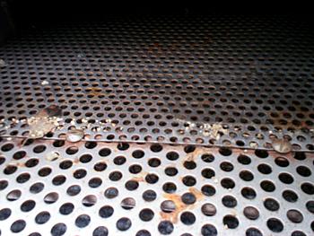

Postby Hoser John » Thu Jun 29, 2017 6:15 am
Almost forgot, the separator plate between the top/bottom is also a great way to adjust the flows on the top/bottom ratio. I too am lousy at posting pics-reducing sizes to post here also. Anyone want to help us old foggies out? I'll email pics and go from there-John
punchplate ramp up and size classifier up top.jpg (24.93 KiB) Viewed 5325 times
Re: keene dredge
Postby LipCa » Thu Jun 29, 2017 7:42 am
john, punchplate has spots of rust....
LipCa
Posts: 112
Re: keene dredge
Postby golden optimist » Thu Jun 29, 2017 8:29 am
You can tell it's a California dredge. If it was from Colorado the punch plate would be shiny from recent use.
Re: keene dredge
Postby russau » Thu Jun 29, 2017 2:48 pm
:D :D :D :D :D :D :D :D :D :D Unless the stainless steel is of surgical grade , it'll have small impurity's and will have some rust! Plus it's NO big deal anyway ,as soon as it runs some material over it it's nice-n-shiney again! Lip I know your just ribbing John :lol: :lol: :lol:
