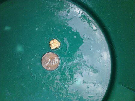

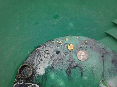

N.H. Gold, I just thought you might like to see this, a fellow over on the GPAA forum posted his latest cleanup from New Hampshire, I don't now where he found this, but his location listed in his profile is central New Hampshire, he didn't post a weight of the nugget, but said "The nugget is a little smaller than a dime and over an 1/8" thick!".
http://www.goldprospectors.org/forum/fo ... shire-gold
Hopefully you'll run into one similar, good luck!!!
