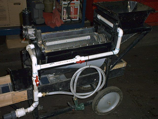

Here is my updated Trammell
Postby stan in colo » Sun Jan 31, 2010 7:06 pm
Here's my winter project.Improved from last year.Hope it works as good as it looks..lol
Rebuilt this winter,many Improvements
trammell 1.jpg (73.14 KiB) Viewed 9260 times

looks nice! i like the 12vdc wiper motor! is this a Bill Fletcher design or is it your design?

Postby stan in colo » Mon Feb 01, 2010 8:26 pm
It is my own design,built from scratch.Stainless frame work,(thin wall),old truck air or vacuum
tank,and the wiper motor,2 speeds.I only use the low side of the motor.Sluice box,is wood,soon to have an aluminum one.Home built riffles,also aluminum.Cant wait to get it out,and get it dirty.

Hey Stan, nice project! With that open mesh you could run the spraybar outside the drum. Where did you find the mesh? The places I've looked have been frighteningly expensive. Looks like your about ready for Cache creek.

Thanks guys, I got the mesh at the hardware store,it is 5/16.Ive got a whole roll of it.And yes
Im ready for cache,got to get the permit yet.But I am ready, I would like to know if my little
2.5 horse 1 1/2 inlet and outlet,will get me water at cache? How far away is the water from the
highbanking area? I think I have about 150 feet of hose.
