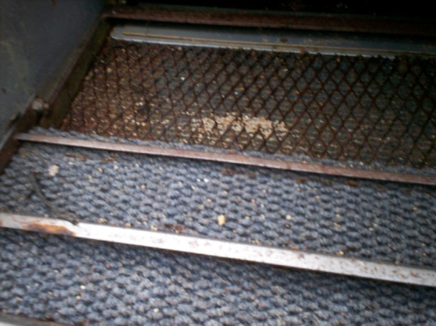

Hoser, for the records, I checked the under box on this here new style Keene 6" and the low profile riffles have a large flat base which presses the expanded metal into the carpet quite nicely. They pulled that one off ???
However, I did notice that on the upper sluice the back end the two last riffles have a slight gap between them and the carpet. Should not be any gold that close to the tailing pile anyhow, so no biggy. :roll:

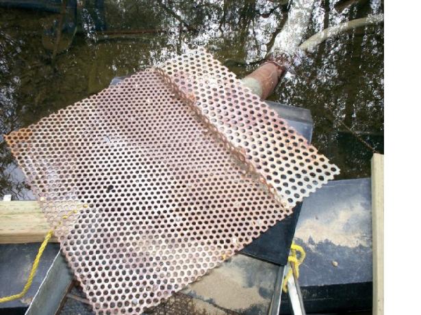

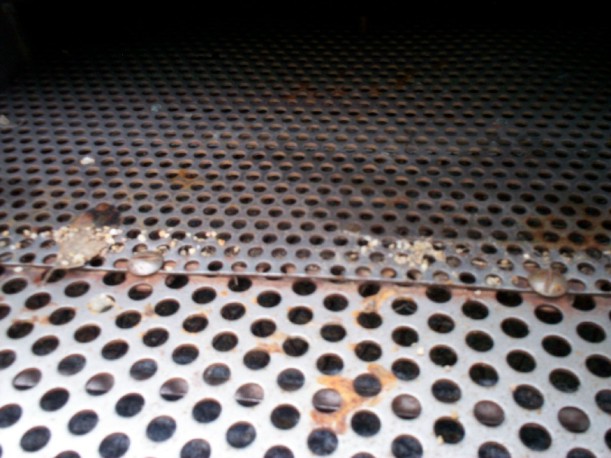

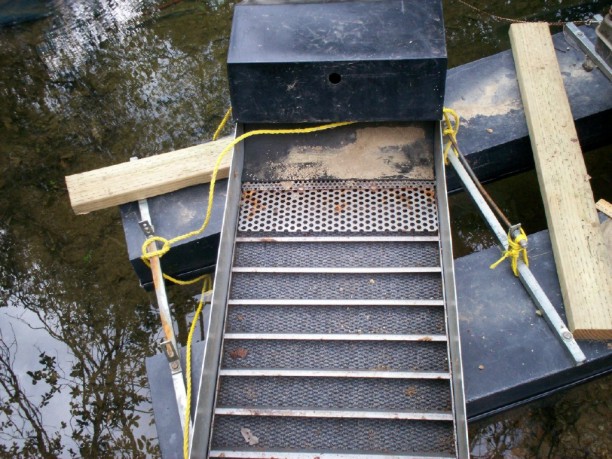

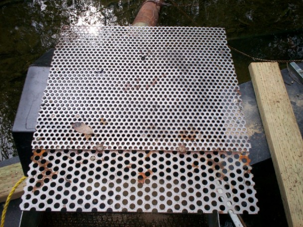

Yet another DOHHHHH I sent all the info to Gunmetal because he sent me a real email addy. Huge troubles with Microsoft erasing XP scan programs and UPDATING me unknowingly-yet bloody again-with 7 VISTA programs my puter won't support :evil: 3 rd time in 4 months I've been disabled on my email scan capabilities. I have tried infanview from GO many times and now it don't want to work either. Maybe Gunmetal can post the email (minus our info) and all can see. Anyhow also forgot to include,up and posting & running since 4 am so 1 more screwup. The rod spacer seperating the slider tray and the top riffles sits on a 3/8" square rod and the rails. The punchplate holes that feed the bottom are 3/16" and top feed to the upper riffles are 5/16" and extend over the smaller riffles to within 1/2" of the top first small riffle to protect the bigger goodies and create a ramp to flow up and out. The punchplate sits almost on the bottom at the rear and sets up on the seperator and over the first tiny riffle. I'll try that stinking infanview again tommorrow when I can see but Gunmetal has the goodies and I am dead dog tired and shot from a long cold bloody busy day. Maybe he can forward to ya or post here.Time to shower and fall out-John :oops:
Re: Ribbed or Nomad? Old argument, I know...
Postby gunnmetal » Tue Mar 02, 2010 9:43 am
Thank You Hoser John
very helpful.
Punchplate size is 3/16" to the bottom feed and 5/16" to feed the small first riffle. It does NOT sit flat but must be about 1/4" from the bottom of the box in back and ramps up to the slider plate that seperates the 2 sets a riffles. Bottom carpet is of no matter but the absolute best AMAZING carpet is indoor/outdoor VARIGATED CARPET. Very high loop,and staggered to increase the retention area considerably. Last pix shows the 1/2" lip that sets on the very edge of the seperator plate. It protects them 5/16" ++ nuggets from the upper and prevents any rocks from going back into the lower box also. It maintains the height at exactly 1 1/2 times the punchplate hole size to allow cleaning on the first mini riffle. The punchplate is about at a 1 1/2" rise from back to front. This forces MANY more fines below and makes all materials crawl up and over for much better cleaning. 12 1/2" of small ans 5 1/2" bigger for top.17" x 15 1/2-angle also allows a bigger punch than flat. John
