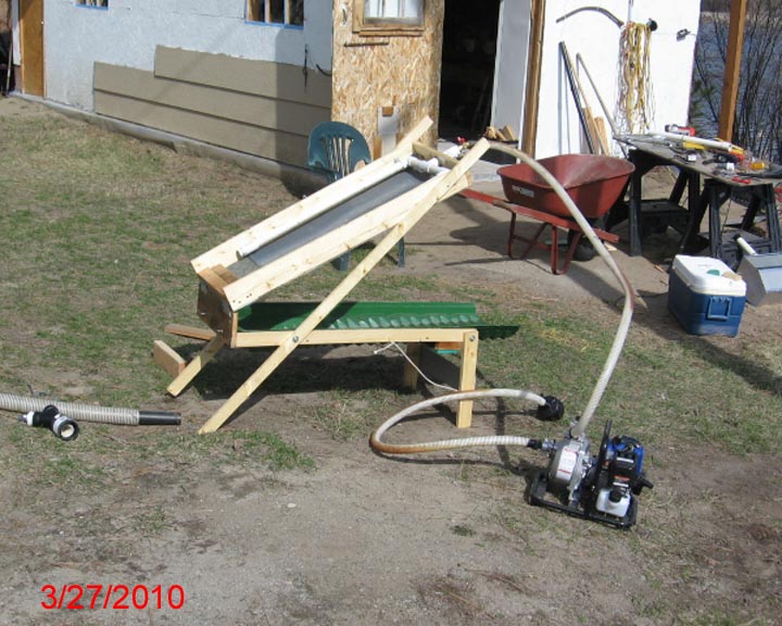

Postby getterdone » Sun Jun 16, 2013 7:19 am
If you use the Le-Trap sluice box it will catch everything. Here is what I built, it all folds up for packing
and I used the Harbor Freight $100 pump.
HIGH BANKER 2.jpg (94.97 KiB) Viewed 14357 times
Re: building a dredge...sluice question
Postby russau » Sun Jun 16, 2013 9:31 am
Nice looking setup! now show us how good it works!
