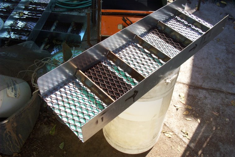

Here's pics of last year's model. This one is 8'x8"x4" per section.

Postby russau » Tue Mar 08, 2011 12:11 pm
Geo what holds your screen/riffels down?

Postby Geo-George » Tue Mar 08, 2011 3:25 pm
russau wrote:Geo what holds your screen/riffels down?
Screen bumps up against the first riffles.
The riffles set into the ribbed carptet.
Ran all summer, nuthin' moved 'til I wanted it to.
Makes for an easy cleanout when nuthin' is atached.
Pick out the pieces and rince into a bucket at the lower end. ;)

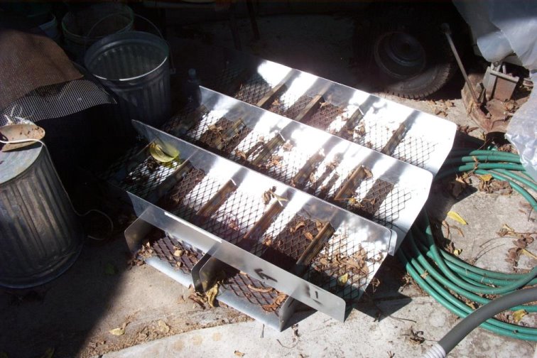

Postby Geo-George » Tue Mar 08, 2011 3:28 pm
Sierra Sam,
Look at the legs on my sluice, 1/2" emt.
Plenty strong enough to hold "Tom" up.
Ya might be able to get rid of some weight on your setup. :)

Postby Geo-George » Tue Mar 08, 2011 6:16 pm
Look at my second pic.
Note that the height is adjustable for each leg, fits any terrain.
Independant suspension. ;)
Each section slips inside the one below it.
Only two legs per section except for the first, lower, section.
That first section has four legs. I set it to slope first, then add
on the rest of the sections. I set the slope on each section as it goes together.
Lay in the carpet, riffles and s'panded metal.
Just add water. :lol:
