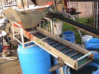

Postby Sierra Sam » Sat Mar 17, 2012 10:22 am
I agree with russau about expanded vs. punch plate. Material can travel over punch plate easier.
Here's a Keene sluice I converted a couple years ago.

Re: Highbanker from a dredge sluice?

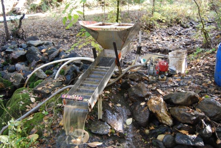

Postby rivraton » Mon Mar 19, 2012 9:18 pm
Sierra Sam wrote:I agree with russau about expanded vs. punch plate. Material can travel over punch plate easier.
Your woven wire is not used in the spot I'm talking about, I was refering to the classifier in the top of the dredge sluice...like this:

Postby Sierra Sam » Fri Mar 30, 2012 8:07 am
Rivraton- Gotchya
I've made a couple classifiers to hang on the edge of a sluice as a receiving "hopper" where expanded steel is used. https://picasaweb.google.com/117818477028979908966/TerryJelcickSHomeMadeGadgets
The Keene conversion you see here in this thread has a 10-11inch extension below where the material initially drops onto the sluice. I did this because I noticed gold being blown off the mat with the splash of water and material being introduced to the sluice.
Now, the material drops onto the flair area, then has 10-11 inches of relatively calm flow over mat before it enters the riffles. More gold now shows up on the mat and I'm assuming, less fine gold is getting blown out. The extension also gives muddy material to have a better chance to break up before its trek through the sluice.
