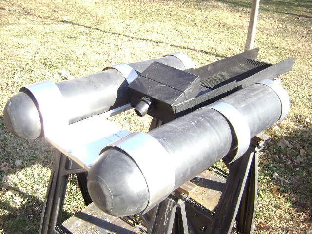

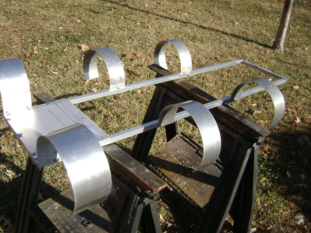

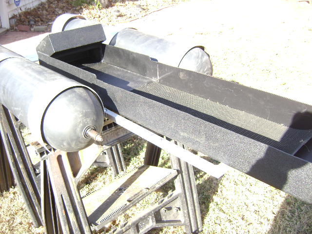

well is anyone working on any projects this winter? ive started a 2 inch dredge because im sorry i sold my 2 inch Proline dredge. its consisting of a allum frame that ive welded up a ABS sluice that i made and its going to have the Gold Hog matting plus i have Vortex and Veranda matts for a compairson runs.itll have a Honda with the Keene P90 pump and itll be useing a homemade venturi nozzel. the floats are a inflateable 48"x8"dia. tubes that will be filled with nitrogen to eliminate the up/down pressure problems with the atmosphere. i like to use a 2 inch dredge to open up a hole for my 4 inch dredge in shallow waters. so far its been fun just makeing it since i couldnt get out this past year.

heres a few pics of what i have done so far.
DSC02271 DSC02274 DSC02275

Postby russau » Sun Dec 01, 2013 3:31 pm
it didnt take all the files. so heres another. picture of just my alum frame.

Postby russau » Sun Dec 01, 2013 3:40 pm
and last but not least so far.... showing the ABS sluice and 2 inch crashbox with a sample of the vortex matting.
