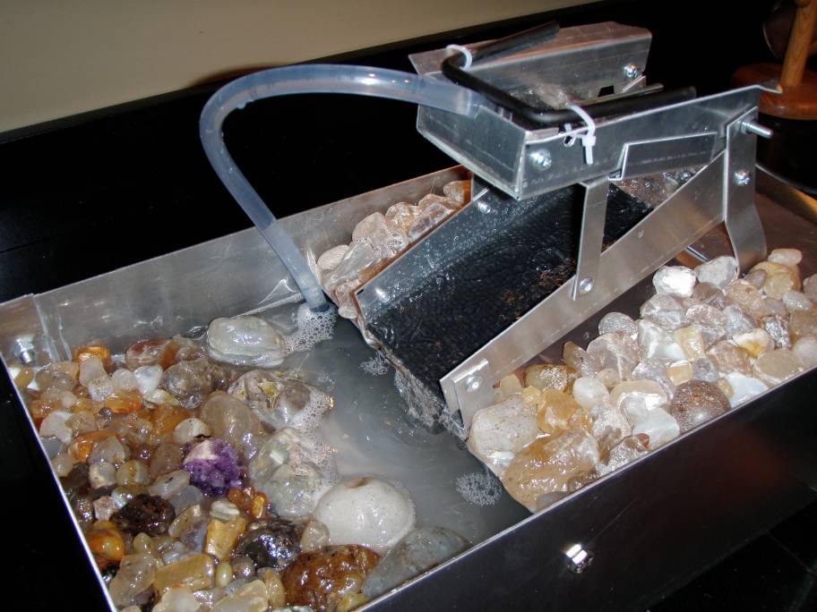

Here is a miniature highbanker water fountain, this was made by a guy in Canada for his daughter, I love it and it has ribbed rubber matting in it so it should catch some gold I would think, this guy makes full size "boiler boxes" as he calls them, and he has them for sale.
Skip
Mini highbanker water feature/fountain
Mini highbanker resized.jpg (100.36 KiB) Viewed 12122 times
