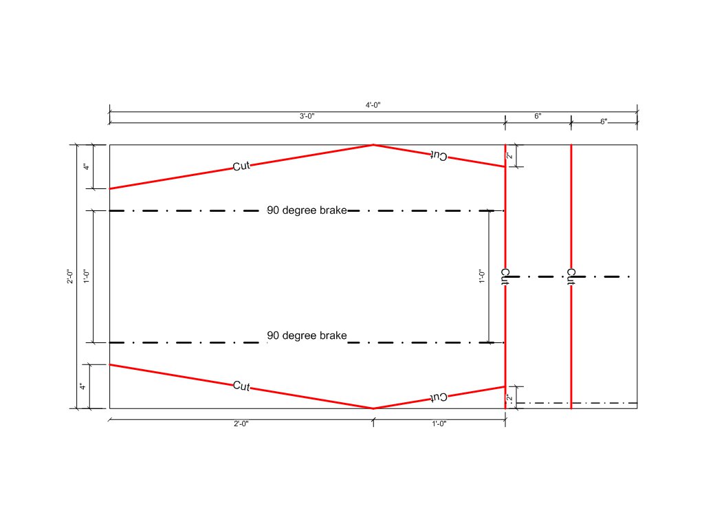

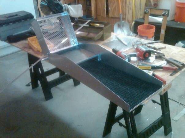

I have been working a project, after seeing these things selling on the net for $400, my wife would have cringed had i bought one.. So I bought the aluminum instead and build it
Heading to the Nemaha to test it on Saturday.
Need to slurg for miners moss, and decent expanded aluminum on the next iteration.. I riveted this one, I am going to use durafix aluminum weld to do the next one it this one works out.
Any thoughts or suggestions appreciated.

Rex i might have the MM your wanting. but its the thick (3/4 inchs) stuff.there is better/other material than the MM. let me know !
Re: classifier/sluice
Postby nebraskadad » Thu Oct 07, 2010 12:31 pm
Russ, Right now I have a fine ribbed matting from Ace® and a ribbed carpet from Menards. The expanded metal is steel lathe, for lathe and plaster. I am going to order some expanded aluminum from Online Metal Supply in your neck of the woods. I am thinking I may build a smaller one, this is pretty light but kind of bulky.. I have a friend who wants me to build one for them. I think I am going to try to use the alumiweld sticks and see how they work.

ive tried all of the alum.weld sticks with a oxy/accet torch. they worked but the weld looked messy! thats why i bought my Miller Tig welder.
