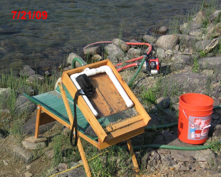

Postby getterdone » Mon Mar 11, 2013 7:35 pm
Home Made High Banker using $90 pump.
HIGH BANKER 3.JPG (107.11 KiB) Viewed 3677 times
Re: Dredge Nozzle insight
Postby Hoser John » Tue Mar 12, 2013 5:50 am
:D luv the Le Trap-John
