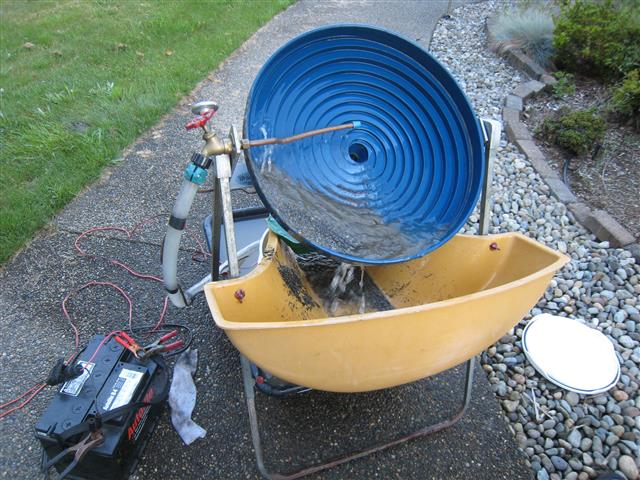

Decided to catch up on a little clean up...
IMG_1861 (Small).JPG (67.07 KiB) Viewed 5686 times

John - question for you. In the pic above I am running my dredge cons through a Gold Screw wheel that is new to me. My old standby wheel is a Gold Genie. After running the cons I feel like the Genie does a better job as I had trouble with the single speed Screw. I plan to re-run the tails through the Genie to see if the Screw missed anything. I pre-screeend everything to -3/16
In your opinion, which is the better wheel for running pre-screened dredge cons?
Re: Dr's Orders
Postby Hoser John » Mon Jul 14, 2014 5:12 am
Question prior to opinion. Do you run 1st time laid back to capture all the black sands-then tilt more vertical to recover the gold from the black sands??. Triple classification really helps wheels-first size-then specific gravity-then gold gravity from black cons(much closer to au sg). I run all cons left over from wheels through either a DAM bowl or mercury treat,as I do my left overs from DAM bowls. I do it in the winter when bored,never got more than a gram or so outta a 100+ lb 7 gallon bucket but sure beats them winter blues and feeds my constant gold fever. Coveth that Genie as one l cool ol'tool. Stay cool this HOT summer and watch them digits :? -John

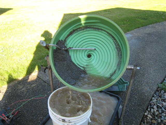

So I busted out the trusty Gold Genie and ran the tails from the Gold Screw. I recovered a bunch of gold the GS missed. However, I feel its important to note the GS did not have a two speed switch and was running waaay faster than the genie. The other difference is I am much more familiar with the Genie as i have logged many miles on it over the years. I have owned gold screws before but not for some years now.
My plan is to rewire the GS for a slow speed setting and run the cons again from scratch. I also think I will screen down to 10 mesh and run the oversize though the mini highbanker
This is the beauty of prospecting....so many choices :P
IMG_1866 (Small).JPG (83.97 KiB) Viewed 5622 times
