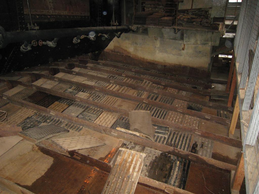

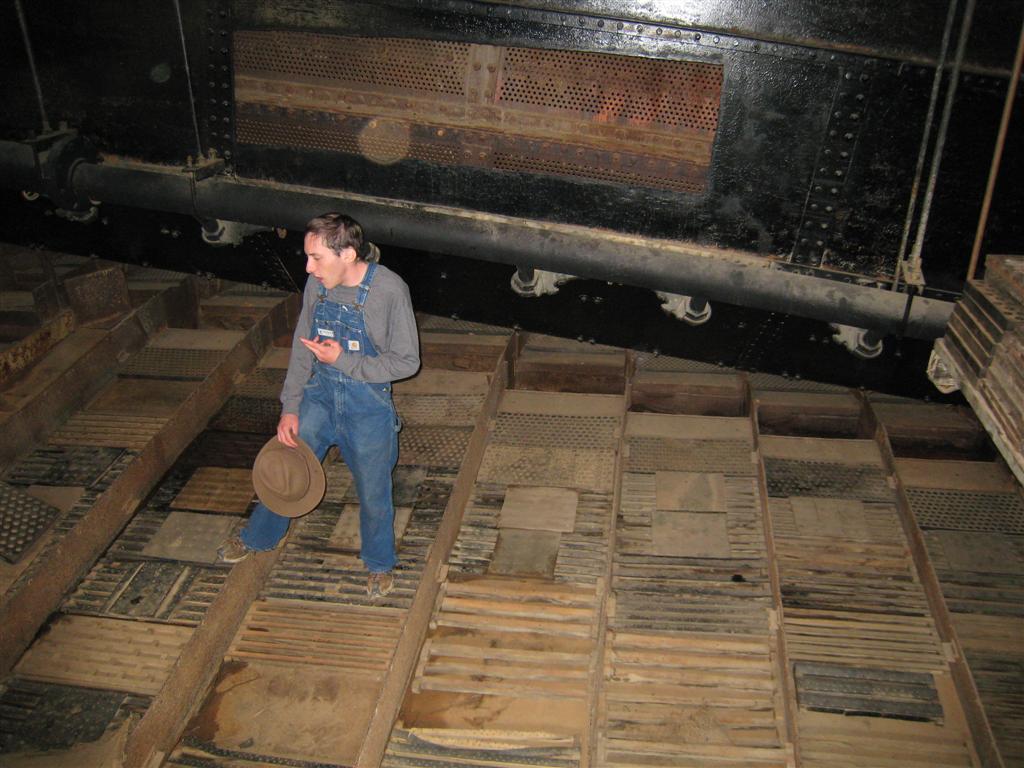

Using HG flotation tables inside large bucketline dredges was common practice because it worked very well. The attached pics show the actual HG tables inside one of these dredges. It's really quite amazing. Huge cascading arrays of steel chutes filled with wooden planks which had pockets or channels cut into them were poured full of HG (many gallons). The dredge would scoop the river bottom and run everything through a large trommel or grizzley to reject the oversize. This oversize was run out the back on a conveyor and stacked into piles (house building material) The classified slurry would then be run across sluices to take out the coarse gold and the fines were sent to the tables. The waste from this was run out a separate conveyor. The HG tables would be cleaned up by diverting the slurry off of one table at a time so production would never stop. Yes, a lot of HG was lost.
Wooden plank with mercury pockets
IMG_0660 (Large).JPG (100.81 KiB) Viewed 4134 times
This is only one side of the amalgamation table. If you look to the left you can see where another table slants off to the other side of the dredge.
IMG_0658 (Large).JPG (112.63 KiB) Viewed 4134 times
The amalgamation table extends behind the bulkhead from the guy. Total dimension of tables in this dredge is probably 30'x80'
IMG_0656 (Large).JPG (118.6 KiB) Viewed 4134 times
