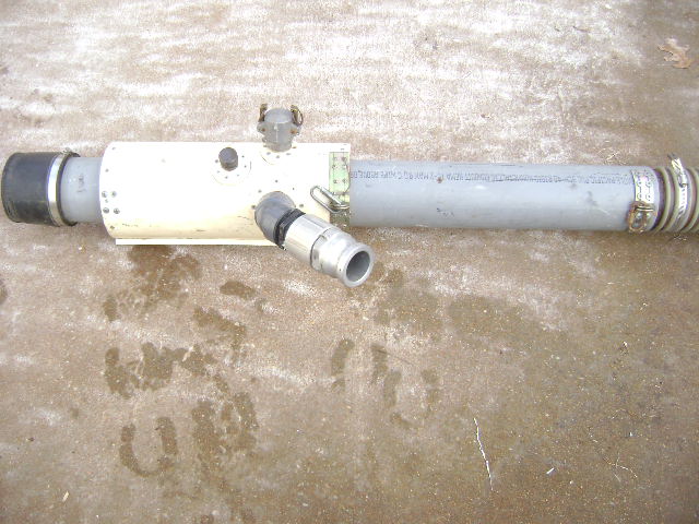

i use one of his 4 inch ventrui that i use on my dredge. i also have a video that he made about his setup. its a VHS tape.

L Dave yes in a sense! it is a PVC ventrui . one 2 inch high pressure supply going into a outter chamber that surrounds the 4 inch PVC pipe and it has several holes drilled into the PVC pipe from that chamber. and they are drilled at 11 degrees towards the flow of the water/material. my outter chamber has several ports that either supply water or exit water out to another device. they are a 2 inch "in" port and a 1 1/4 "out" and a 3/4 "out". i use these ports for my blaster hose. it is somewhat heavy for a jet but it works fine for me! I thought everyone knew of the Vortexrex device!:) id take a picture of it but its packed away for the winter. if i get a chance ill see if i can pull it out easily and take a picture of it now that i FINNALLY know how-2-post pictures.:)

heres a picture of Daves device. the black no-hub connector is where my 4 inch suction hose attachs. EZ to attach/unattach my hose .

Postby libertydave » Thu Dec 19, 2013 10:00 am
Thanks, Russ
Novel concept and thanks for the photo. In my books anything that successfully recovers gold ranks high and I always enjoy learning about innovators who create new things that perform well.
Chuck Lassiter's Hydro-Force dredge nozzles have also been a big seller because he came up with a tool that can be used on existing equipment and offers the operator expanded capabilities. Saw a lot of them last summer working exposed bedrock in Oregon.
Regards, LD

Postby russau » Thu Dec 19, 2013 12:34 pm
i might add that ive used this PVC device for about 10 years now and it still is working fine despite the PVC construction,i personnaly know Chuck and his Hydro-force nozzel and it is a good peice also!

Postby Bonaro » Thu Dec 19, 2013 10:43 pm
The hydroforce is nothing new...only refined and it does pretty well
If you apply enough horsepower to any venturi or nozzle jet it will suck material off a dry beach
The vortexrex is very simular to a hydroforce in concept except the vortexrex is waaay bigger
